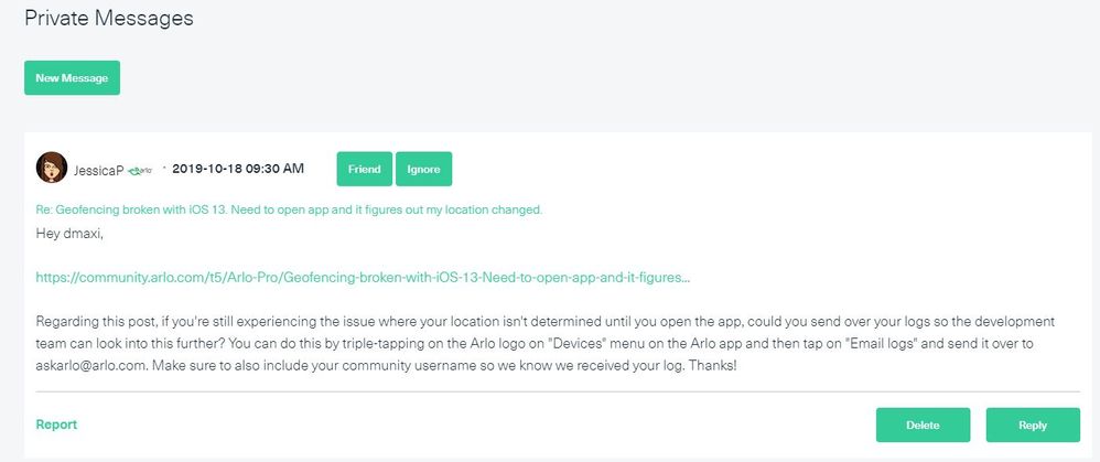

I received a private message from one of the moderators, Jessica, in October (attached below). I've sent the logs, and latterly a follow-up message, but no response publicly.
