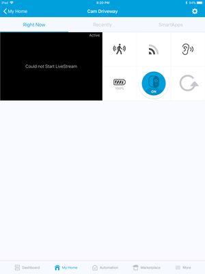

Can’t access my camera. Says offline and didn’t save the last clip. I’ve reset the Arlo and Smartthings hubs but still doesn’t work. Anyway to fix this without going up the ladder once again, to pull out the battery. Thanks...

Thanks Tom. Yea, I already did a reset and a power reset, no luck. Guess I need to get out the ladder...again...what a pain. Got a lot colder sonce last time, too. At least it is not on my 2nd floor soffet.
