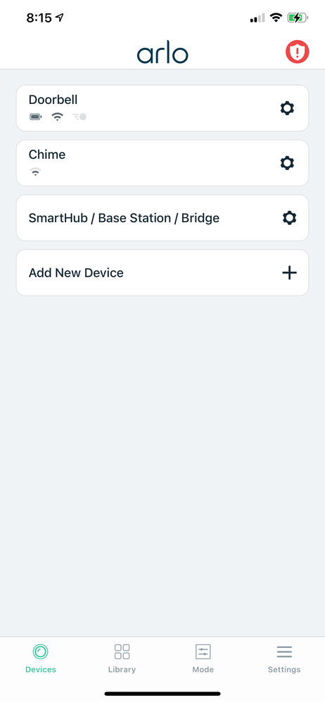

Exactly the same problem except when I tried deleting the app and downloading again but there was no change. Strange but I am getting text messages that motion has been detected but since there are no devices I can not view the videos on my iphone BUT videos appear when I log in from my laptop.
So it must be Iphone mobile app issues.

Same Issue. Updated the app. All cameras and recordings disappeared. Add "new device" and the base station found all of the cameras. Two days later, the app shows no devices or recordings. Added "new device" again, all the cameras and recordings came back. Very frustrating. I hope the support staff notices this trend and addresses it soon.

Same issue. Three of four cameras disappeared from Arlo app on iPad, but are still visible on Arlo App on iPhone. Note Apple just pushed another security update, I’m running iOS 14.4.1 on iPad 4 and the newly pushed 14.4.2 on iPhone 11 Pro Max. Could this be a compatibility issue?
I added the cameras again using the iPad. They successfully added. But still do not show in the app on iPad. They do show on the Arlo app on iPhone, with new camera names create when I re-added these cameras using the iPad. To clarify: I successfully re-added the missing cameras using Arlo on iPad. They still do not show on iPad. But do show in IPhone, with new names I gave them when re-adding on iPad.
i uninstalled and reinstalled Arlo app on iPad. Cameras still do not show. This appears to be a software issue?

I'm having the same issue with my Arlo Pro 2s. First noticed today. Still getting motion notifications, but no devices or recordings in the app. I have the most recent app version. Uninstalled app and re-installed, restarted phone (iPhone X) for good measure. No luck. Husband's Google Pixel 3 is working fine. So frustrating.

I have the latest OS system also. Seems there may be a glitch (obviously) as i can start the app, the ARLO page comes up, then it switches to the page where you can select the base station or add devices. Then the red alert button pops up in the upper right corner. Sometimes this is where the app stops. But sometimes, the app then switches to the page to select devices, library, mode and settings at the bottom. Sometimes takes 2-4 seconds to make that last switch though.
