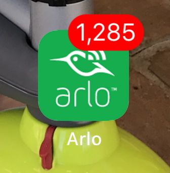

I just went outside and triggered an event. Got the push. Push Badge on app showed 1285!

I've not been able to replicate this based on the discussion here. If possible, please provide a screenshot of the badge displaying the erroneous number of notifications and I will escalate this issue.
Please see attached screen shot James. It'll go from nothing to 1285 (this number keeps increasing over time) once I receive an event from one of my cameras.
From what I can tell the badge number shown is the total of "unread" videos from both accounts - mine and my family member (which granted access to my account). The "unread" count from my family member still increases and will be added to my account even after she removed my access.
So say I launch the arlo app and go to the Library tab. It will reset all count to zero. The badge icon will be zero as well. However on my the next event from my camera it will show 1285. I'm quite sure it's doing 1284+1 = 1285. The "1284" count comes from my family member's account and this keeps increasing, it was 100, then 300, then 500. then came to 1284 after a few days.

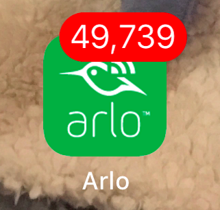

James, please find attached screenshot of the badge notfications. I have also been experiecing the issue and these numbers have been incrementing since i was removed from previous devices that were shared with me.
Hahaha 49739!!! You win! 🙂
Thank you for the screenshots. I will provide an update on this as soon as I have more information.
