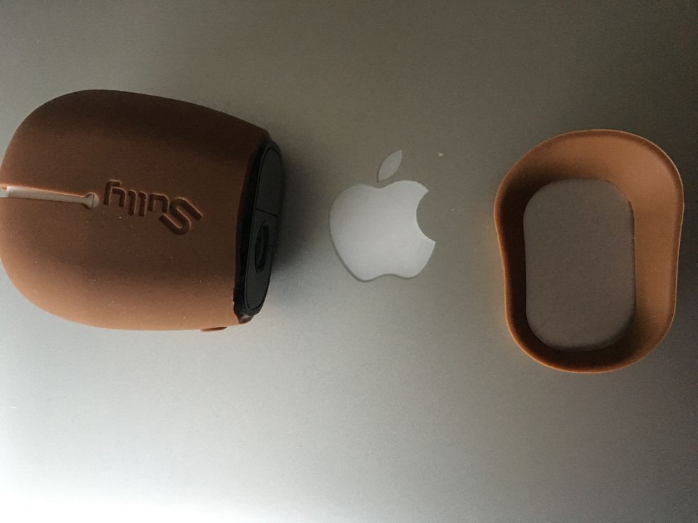

So, following the great advice listed by members, I performed surgery on a brown skin on one of my exterior Arlo Pro 2 cameras. (Someone asked earlier why buy them if they don't shield the lens. My answer is that we want to disguise them, not advertise with shiny white easily stolen technical marvels. My 2 pergolas are stained golden brown. These skins blend in nicely. And spiders can't nestle in easily like they can around the hooded portion).
I used an Exacto knife (no local anaesthetic), cutting outward from the front face all the way around. That way I avoided scratching the face, and kept the skin tight to the black plastic, and also avoided exposing the white plastic.
This was done during the day, so I dropped the camera into a laundry basket in the dark and turned on the camer from my iPhone. Nice, crisp detail! No murkiness, So I won't be sending the skins back.

Can you post a photo or two of your skins installed?
- Email to a Friend
I would suggest pulling the skins back about 1/4 inch from the front face of the camera, sit it outside on a horizontal surface at night, and see whether there is still interference. I would suspect not.
The camera has quite a wide ange of view, and if there is even a small amount of skin forward of the plane of the camera front, you may still expereience a problem. With mine cut back as per my photo, I have had very clear footage ever since.
That's why it would be good to see a photo of yours installed from a couple of angles.
