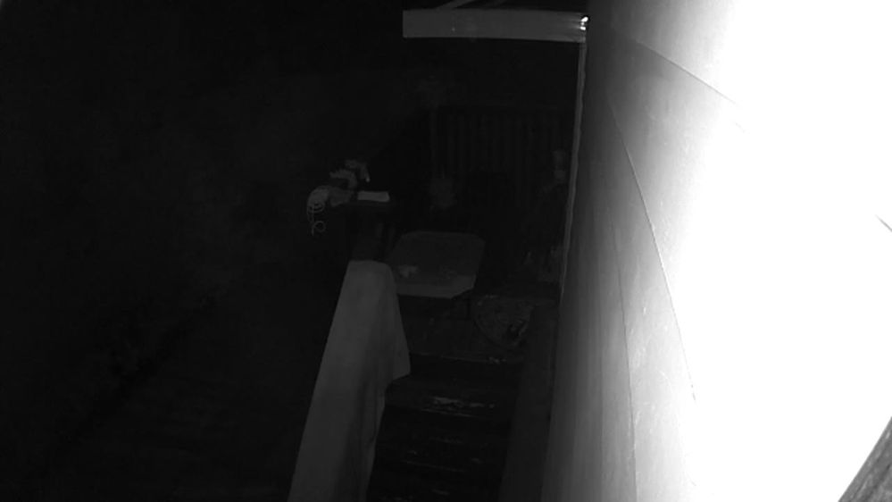

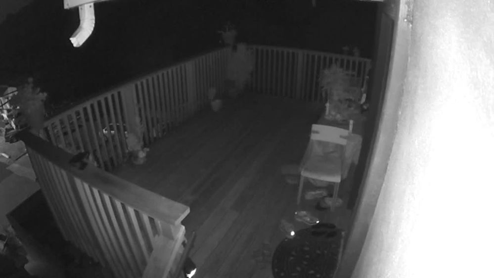

One of my arlo Pro camera is mounted on. A wall that is painted an off white color. Does this effect the IR night vision where it reflects off the light color wall and causing it to drown out the rest of the area? The pic is how it looks. Is this normal and any suggestions?
Totally missed the attachments - sorry.
It's obvious now that I've seen them that the wall is causing the issue. If we had manual control of the exposure we could work with it but we don't so...
Minimize or eliminate the close-by wall from the view and things will look MUCH better.
It appears that you didn't actually attach any pictures - nothing is showing.
Light reflecting from any nearby object will affect the camera exposure just as it does with any other camera on automatic exposure. The camera sees the brightness and dials down the exposure. Minimize the amount of unwanted/unneeded wall or other object and the exposure will be much better.
yes it can... aim so little of the side wall is in view
I moved the camera to point away from the wall as much as possible and the night image is now much better. Thank you both for your help.
