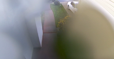

I recently installed an Arlo Pro outdoors and it seems to work well. However, today we had some rainwhich covered the camera lens. This rendered the camera unusable. Below is a screenshot of what it looks like.
Are there any solutions to this? Are there any accessories that can cover the camera to protect it from the rain and snow in order to prevent this problem? Thanks!

New Arlo Pro owner here. I'm having the same problem at night with IR light on. Of course, with IR off, nothing can be seen because it's too dark. My cam is facing down at about a 45-degree angle, so if this is due to water on the face of the cam (most likely), it must be flowing across the face from the body. I'm going to try the skin.
Yeah, i don't see this as anything Netgear can fix, it appears that it is simply rain reflecting off the IR. If anyone reports the skin helps, i'll buy it also.
You could try Rain-X or similar on the lens but that's about it other than putting the camera in a location less prone to water exposure.
I've seen this and it for me appears not during rain but with a small mist or afterwards...with raindrops on lens.
It usu take a short time to dry off, but not much to prvent it.
Except, some have talked about waxing the front or rainx that some have used on car windows...don't know if it will work but maybe worth a try.
More likely if possible mounting under a soffit or gutter to stop it some what.
OR attaching some sort of 'duck bill' above it to prevent same... I've seen someone mount their cam in a 4" piece of PVC tube ( painted to match background ) for protection and that one didn't have rain... maybe think outside the box is needed.
