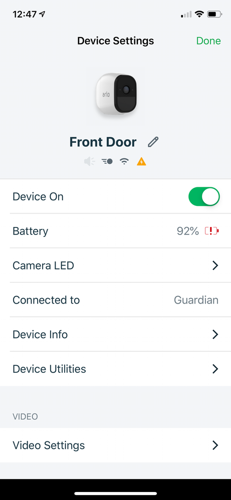

What does this icon mean on my arlo pro camera? The lightning bolt in the yellow triangle. It’s attached to a solar panel. It’s been working for over a year. It snowed yesterday and temps in the single digit.

Prob a notice that the temps is to low to charge....
The battery circuit will NOT allow the battery to charge if the temp is below 32F... as this can damage the cells
When the temps climbs above freezing, charging will start again
