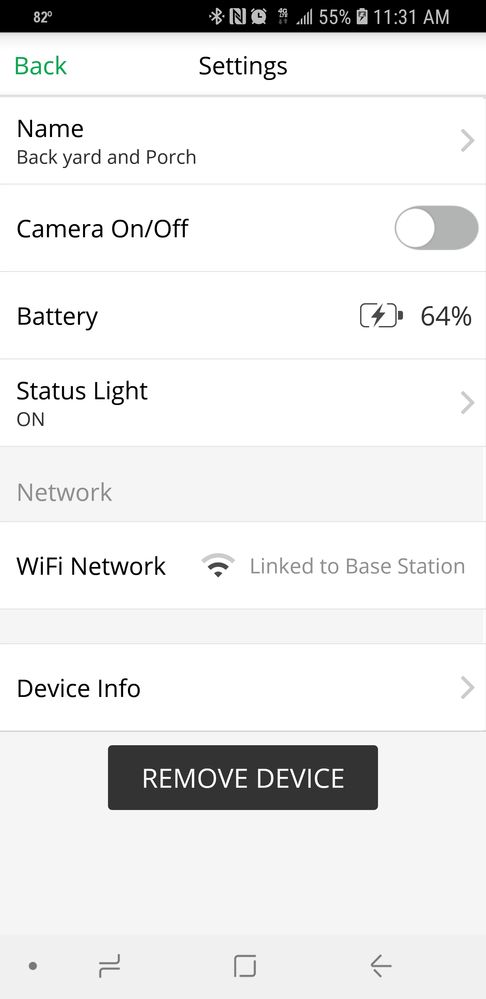

I have three Arlo cameras. I bought the Arlo Pro 2 kit with two cameras and ordered a third camera from Amazon. But I bought the Arlo Pro instead of the Pro 2 by mistake. All three cameras are plugged in directly for CVR. But:
CVR isn't available for Arlo Pro even if it's plugged in
Battery won't stay charged even if its plugged in like the other two (Arlo Pro 2) cameras. I charged the camera to 100% last night and plugged it in. Woke up this morning and it was down to 80%. So I disabled it. Here it is ~16 hours later and now it's at 64%. How is this even possible?

It may be defective... can you return or contact Netgear for warranty

Think I'm going to return it to Amazon for a full refund and order the Pro 2 instead. This is ridiculous! At 57% now and it hasn't even been two hours. It's not even active! I wouldn't expect this to have this much drain in normal conditions no less while deactivated AND while plugged in.

So... the camera eventually died on me in about a day despite it was plugged in.
But just for the heck of it I removed the battery and plugged it in and it's running just fine without the battery.
Does that make any sense to anyone?
I'm definitely returning this piece of crap!

Having it work fine without the battery in it and plugged in makes sense, it's designed to work that way if you want.
The battery draining while the camera was plugged in makes no sense. Either you had a bad conenction or you have a bad battery.

The Arlo Pro cameras will only charge to an actual 80% when plugged in although the indicator shows 100%. This is to protect the battery from long-term overcharging. It's by design.

I am having the same problem with 1 of my pro 2 cameras.  Did you find the cause or solution to this?
If the battery is discharging while plugged in there are various possibilities. For starters, is the camera indicating that the power source is plugged in (lightning bolt on the battery icon)?
1) Bad camera
2) Bad power supply
3) Wrong power supply (needs to have both 5v and 9v outputs)

Nope. Just returned the camera. The replacement worked just fine.
