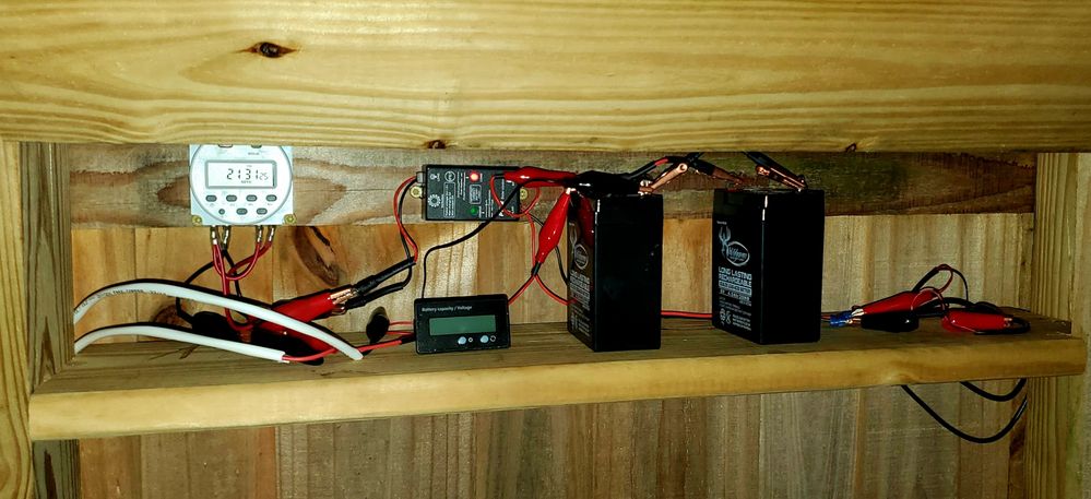

Wrong. I'm charging two cameras with 2 6 volt 4.5Ah batteries in parallel connected to a 6v charge controller and 2 7.2v solar panels in series. I'm also charging 1 camera (connected by USB port) to my Enphase Envoy (communication gateway) from my solar panel setup. The remaining 2 cameras I ran through the attic, into my garage, and into a surge protector that has 4 5v 2a USB ports. I've had the fault error with 2 cameras and one was my fault when I spliced the charging cable; a strand of copper touched the opposite wire. That was an easy fix. The other one was water getting in the port, so I greased up the USB port and plugged it back in. Also an easy fix. If all yours are having problems now at the same time, I don't know what the issue is....

Wrong. I have two cameras connected to two 6v 4.5Ah batteries in parallel, a 6v charge controller, and two 7.2v solar panels in series. I have one camera connected to the USB port of my Enphase Envoy for my PV system. The remaining two are connected to a surge protector in my garage that has four integrated 5v 2.1a USB ports. I had two cameras give me the charge fault error. One was my fault due to a splicing error I made, and the other was water getting in the camera USB port. I fixed the splice and greased the port of the other camera. I've had no issues since.
