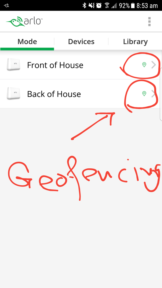

Since recent update of the android app or arlo backend system geofencing no longer working as intended (since 15/05/2018). I can select Geofencing and it accurately selects "home" mode. However, rather than selecting the correct arlo mode, the system just "disarms" . I have tried many mode pointing towards "home option" it still does nothing. The app or web interface used to show corresponding mode selected based on Geofencing programming. Now just shows a "location" icon.
