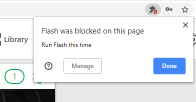

I cannot login to my account on my PC using Chrome (current). I read the entire thread. When I try and login I see 'plugin blocked' on the browser bar. I have "allowed" flash, still get the same message each time.
Click on the flash blocked icon, choose manage, under Allow add: https://arlo.netgear.com:443 and also add https://arlo.netgear.com. Close browser and try again. If you still see the blocked again, ignore it, mine always says it too, but everything works fine.

There is a "f" item showing up in the Chrome URL field, you have to click on it and mark "Run Flash this time."
This seems to be the "standard" for the current Chrome 71, the next Chrome 72 (as per the Beta), and very likely Chrome 73 (Chrome Canary build).
