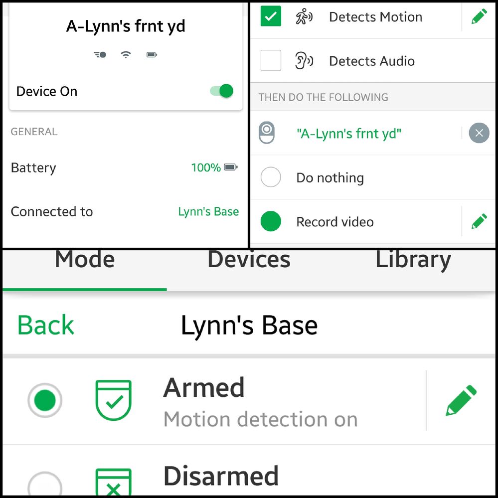

Ok, I spent the day retrieving cameras from their mounts, removed and reinstalled the base and synced the cameras.  I have 2 of the 3 cameras detecting motion now.  The 3rd camera is still not detecting motion.  It is currently raining so Im inside doing testing.  I put a fresh battery in the camera and removed and resynced it several times with no change.  I put all 3 cameras on a shelf and walked by several times.  The 2 cameras (B snd C) work as expected.   The 3rd, labeled A-Lynn's frnt yd still doesn't detect motion.  I have provided screen shots of various pages specific to this camera so you can see what I am seeing.  Am I missing something?

How do I go about getting a replacement for this one defective camera?
