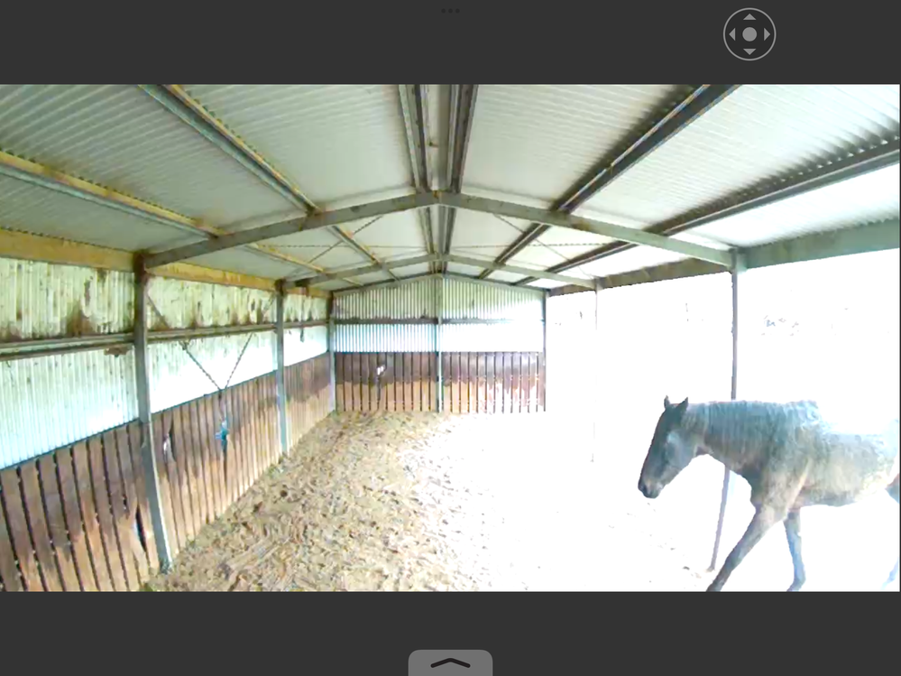

Additionally, it is only in the Library screen (fine if I go to the devices or settings or modes screens) that the integration with iPadOS breaks down when swiping up, and instead of going to the view of loaded apps, I get this little up arrow tab at the bottom of the screen and I have to use double click of the button instead of the swipe up.
I'll try to attach a screen shot, but attachments didn't work when I first posted this issue, so if it's not there I'll try an attachment without a message and if that doesn't work, you'll have to visualize what I am saying

3) swiping up to show all loaded apps does not work and instead shows a small tab at the bottom of the screen with an upward facing arrow in it (see attached screenshot in previous post).
