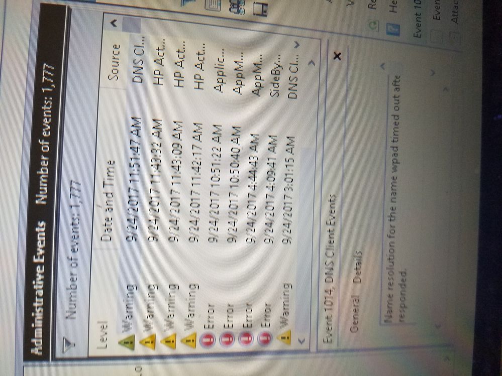

Here are pictures that I took as these techs were showing me the network virus threat, and the many foreign addressess, as well as the amount for the cleanup packages. I couldnt attach with my reply for whatever reason.
This is what they were trying to charge me for and all the different packages to remove the network virus that was ruled out as FALSE by the technician we paid to come out and look at the cameras and computer.

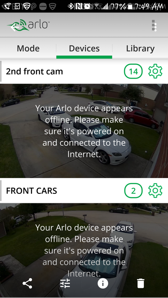

I did exactly what you said, the cameras came back up but just as soon I thought it was gonna be good the cameras go out and it tells me my cameras are offline and they stay off for a few seconds then they come back up. Now this only happens when I'm going to view a live feed or when I'm going to arm the cameras and sometimes if I'm in rhe middle trying to change the sensitivity of the cameras. I'm not sure if it is the base station or like the technician said a glitch in the app. I will attach the screenshot of the message it gives me. Now they do come back up but if they take a bit longer then I have to go into the app settings on my phone and clean the cache, then completely close out the app and sign back in.
