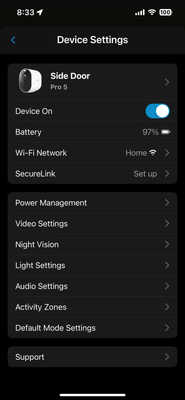

I recently purchased a pro 5 camera and every time I try to pair it to secure link it doesn’t.
It'll flash blue lights, then flash Amber twice, and say it could not be paired to try again . I’ve done every type of troubleshooting I’ve removed Home security reinstalled removed pro 5 camera reinstalled reset my network deleted Arlo app reinstalled and nothing has seemed to work to get my Arlo pro 5 to connect to secure link
It’s connected to my 2G and 5G just not my secure link
Did you try what's suggested at the bottom of this link?
There’s no one option to toggle the secure link on or off just the device. So all I do is set up and has me click pair and I do and says try again so like I mentioned nothing works I’ve removed camera and home security and reinstalled and nothing
