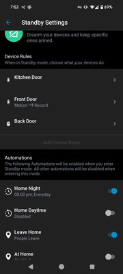

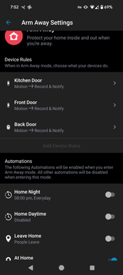

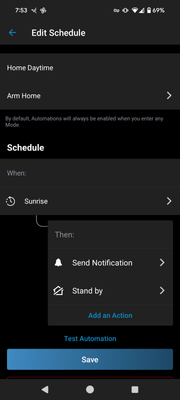

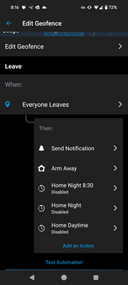

Currently I have the routines set up so that when I leave home it disables all time based routines, and sets to Arm Away, the issue here is if I come home after the time based automations, the cameras become disarmed and stay disarmed all night unless I intervene. Also lately even though the Arm away automations triggers as expected, however the morning time based automation will still activate disarming the cameras even when I'm not home and the sunrise automation should be disabled.
Screenshots:
Last night I spent the night at my GF's house and it armed properly, but I woke up to it being disarmed:
Leave home automation:
Arrive home automation
Sunrise automation:
All automations, I was going to set up a time based arming automation every 30mins throughout the night to counteract me coming home after sunset disarming them... But gave up cause there's no way that's the only solution

Broadly, what you need to do is reserve the use of Arm Away for when you are away (e.g., geofencing). Then schedule Arm Home and Standby. I usually recommend arming all cameras in Arm Home, and modifying standby if you want to arm cameras between 8 am and 8 pm. But it'd be useful to know more precisely what you want before settling on how to set up the modes.
Once we lock down the modes, we can set up enable lists in the schedule automations so that the automations are disabled when the system is in Arm Away mode.

No. I am recommending that you modify "Standby "to arm the doorbell (without notifications).
Then you enable schedule automations in "Arm Home" and "Standby", but disable them in "Arm Away".
"Leave" is enabled in all modes, and "Arrive" is enabled only in Arm Away.
These settings ensure that when you leave, the system will stay in "arm away" until you return.
Let me know if you need screenshots.
