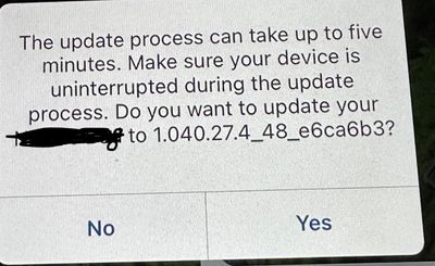

I have two Pro 5 cameras that are connected directly to wifi and they both say need to update the firmware but when you click on “ update firmware” nothing happens. The firmware doesn’t update and it still shows that I need to update the firmware. My other pro 5 cameras that are connected to the base station do not have this issue.

All 5 of my Arlo 5S cams have a message firmware update available. When I go in and say ok to the update warning nothing happens. I tried the web portal and it gives an error that update is invalid. Thanks again Arlo. Just keeps getting worse the longer I try to use your product. 😡

Same here started today on all 5 pro 5S cameras. 4 at my home and 1 at my camp on separate Arlo secure paid plans. No response from support. Nothing I have tried works. When I tried to update via the web portal I get an invalid firmware error.
Yes just started this morning. The firmware my other pro 5’s show which are up to date show the firmware as: 1.040.27.4_48_e6ca6b3
This is what the two pro 5 cameras show as the current firmware needing updating
1.040.26.2_56_6649b4f. But when you try to update nothing happens. The firmware updates usually happen automatically…I’ve never had to update the firmware except when I’m setting up a new camera. It’s like it is stuck and won’t update. I find it weird that it is only my pro 5 cameras that are connected directly to wifi instead of the base station.

I'm having the exact same issue on all my 5S cameras as of this AM. I have tried updating through the app, the website, power cycling (removing the battery) nothing works.
saying yes or no to the upgrade results in exactly the same result - nothing, and still stuck with the exclamation point and no live view.

None of my three cameras showed any image, or ability to view a live feed. All three panels were dark, and in the center of the panel was a white circle-icon with a red border and red exclamation mark inside. It has remained like this since. When I tap the icon, it brings up a "notifications" page that shows a red triangle with an exclamation mark inside, and a label next to it reading "Firmware update is available", with an "Update" link below. When I tap the "Update" link, I get the message mentioned by OP: " The update process can take up to five minutes. Make sure your device is uninterrupted during the update process. Do you want to update your *Camera* to 1.040.27.4_48_e6ca6b3?" - Yes or No. When I tap Yes, it simply closes the prompt and returns to the main page, and the blank feed-panel with the icon remains.

3) I added one camera as a new camera. The pairing process worked like a charm. But on one of the final panels, it read "checking for updates", and quickly progressed to a panel that read "Updating Firmware - The firmware on your Camera is currently updating. This could take up to 15 minutes".
-- After 20 minutes, the screen updated to read: "Firmware could not be updated. - The firmware on your Base Station has failed to update." "Base Station" ? I don't have a base station. This panel had two options "Try Again", and "Try Again Later". Since I did this multiple times, "Try Again" yields the same result after another 20 minutes, and "Try Again Later" brought me to the next step, where it shows a preview of the camera feed for positioning - this worked! I was able to see a live feed here! So I hit continue, and I get a message that says the camera has been successfully added. I can either "Add another device" or finish. I clicked finish, and it brought me back to the dashboard. I inspected devices, and the camera was there, but once again it was blacked out with the circle icon indicating a firmware update is available.
I did an inspection, and my current firmware for all three cameras is version 1.040.26.2_56_6649b4f
The firmware it's trying to upgrade to that is failing is 1.040.27.4_48_e6ca6b3

The issue still persists for my cameras. How can you tell if they are updating? I just tried to tap the exclamation icon and then the "Update" link again, and I'm still getting kicked back to the previous page.
The team has found and resolved the issue that resulted in the update failure. Firmware should now update successfully as long as the camera has good signal strength and battery life. You will need to restart the camera from within the Arlo Secure mobile app and then click update firmware on the camera widget after the device has finishing restarting.
Please try again and let us know if you continue experiencing the same issue.
I am still not able to update the firmware….nothing has changed for me. I am getting motion and notifications and I can see the recordings on my feed. I can live view because the camera shows the icon to update the firmware…
