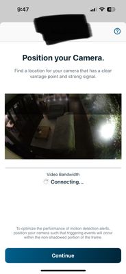

Hi @BrookeN - I’m having major issues with my cameras. This time, one of the Essential Spotlight cameras was also playing up, as well as the 2 Pro 5s.
The Pro 5s firmware was updated with the older filed trial firmware after you arranged that - the front door camera picked up the postman on Friday so it seemed to be working. However, this evening (Saturday), I tested the cameras by walking in front of them because often they don’t work well in low light. Neither of the Pro 5s picked up anything when I walked in front of them multiple times, waving my arms. So, worse motion detection than ever - they weren’t detecting anything and the spotlights weren’t coming on once it got dark. One of the Essential Spotlights was the same - there’s nothing wrong with my internet connection. To try and resolve whatever is going on, I deleted the app and reinstalled it. Then I removed all 4 of my cameras and reinstalled them from scratch. The front door (Pro 5), side garden and side garage (both Essential Spotlights) all came back online and started recording motion again. The front door reinstalled version 1.050.33.10_105_3a163f7. However, the garden camera (Pro 5) has completely stopped working. During the reinstall process (which I’ve tried 3 times), I had to manually synch the camera to get the blue light to flash (the other 3 started flashing on their own). After reinstalling, all I could do was access the live feed. I did a motion test and the orange light flashed but no recording and no notification, even though it’s set to arm away. When I reinstalled the garden camera, it installed version 1.050.33.6_71_393f539, but during the install process (all 3 times) it stayed jammed on the last stage where it sorts out the video bandwidth and wouldn’t connect (I’ve attached a screen shot). Although I could initially access the live feed, it won’t connect at all now, so is completely useless.
I have no idea what to do to try and fix this issue - given the camera seems to have completely malfunctioned and won’t reconnect (all 3 other cameras are connected), and there have been ongoing performance issues since I purchased it 9 months ago, can you please authorise a refund through Arlo? The store I purchased the cameras at won’t refund me after 9 months. I can’t keep dealing with the lack of performance (and I shouldn’t have to) and I need to replace at least the Pro 5s that won’t work at all now with a working camera. I don’t use these cameras for fun - I use them for security. While I appreciate that you have tried to help to sort these issues out, this has gone on long enough and based on today’s events, is getting worse, not better. The fact these cameras aren’t working is causing me significant stress and anxiety and I expect Arlo to provide a solution.
@BrookeN - an update to my post above. After spending ages googling online to see if I could work out how to fix the garden Pro 5s, I did a factory reset (pressing the synch button until the orange light flashed) and then reinstalled it again. It went through the reinstall process properly, and has come back online with the ‘105’ firmware version - so now both my Pro 5s are no longer on the earlier field trial firmware. I’ll keep testing them tomorrow to see what their performance is like, now they have been reinstalled. I’m fairly disappointed they randomly stopped working to begin with - surely that’s not normal. In sheer desperation, I also upgraded my subscription because it seems the one I was on no longer exists. So now I’ll be paying more each month for cameras that continue to give me grief.
Hi @BrookeN - a further update to my posts above. Since removing and reinstalling my cameras, and factory resetting the garden Pro 5s, all 4 cameras appear to be working normally. So far, the Pro 5s look like they’re picking up everything, better than they have been, including when they were on the older field trial firmware last week. The notifications are still laggy, but they’ve always been a bit slow. I’m ok to stay on the ‘105’ version of the firmware for the Pro 5s cameras, seeing as it looks like it’s working. I’ll let you know if there are any issues.
