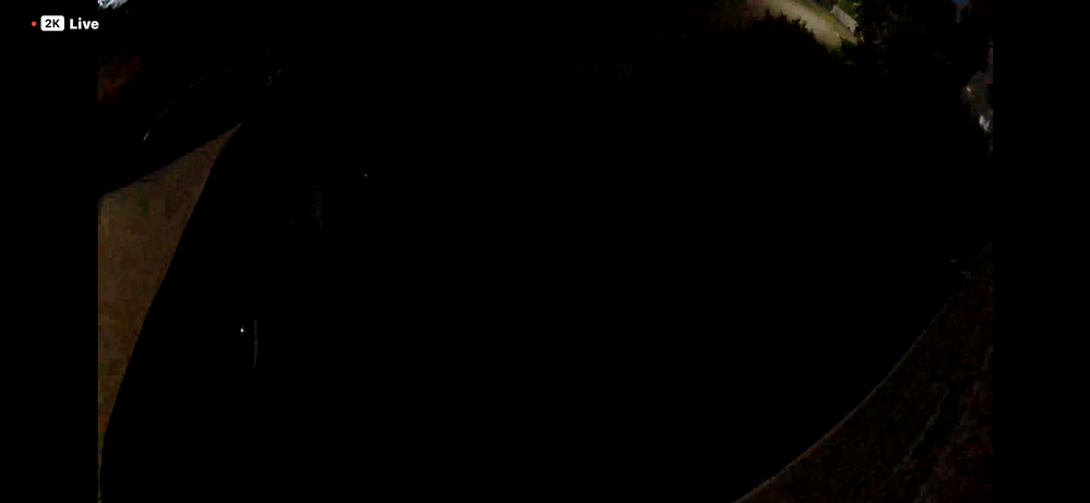

@BrookeN, would it be possible to get my Pro 5 moved to the field trial please as I would like to see if it fixes my main issue which is a lack of alerts overnight.
I have mentioned it before but often when I look at my camera at night the image is just a dark or pixelated mess.
This was after dusk last night:
I then flicked the torch on and discovered that my cat was actually sitting there!
She moved almost immediately which triggered an alert but she had managed to get to that spot without triggering one.
Once the recording finished, the camera revered to displaying the infrared camera but I suspect if I hadn't intervened the camera would have just spent the night showing the dark image and not detecting anything:
