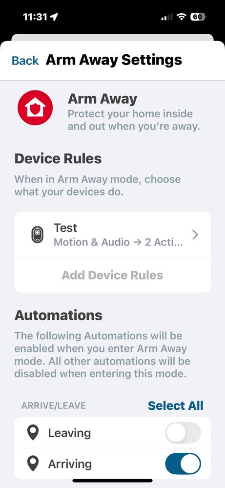

Screenshots attached.

Right now Arriving is disabled in Arm Away mode, but enabled in Standby (and maybe Arm Home - can't tell since you didn't post that one). That is exactly backwards from what you want. The system should be in "Arm Away" when no one is home, so you want "Arriving" to be enabled in "Arm Away". Normally I recommend disabling it in both "Standby" and "Arm Home". But if you are only using one phone for geofencing, it is ok to enable it in "Standby". (Even if you are using multiple phones for geofencing, if you never want to arm the cameras when someone is home, then it is also ok to enable it in "Standby").
Similarly, "Leaving" should trigger "Arm Home" and "Standby", and you have it disabled in "Standby" (and maybe "Arm Home"). It is simplest (and safe) to have "Leaving" enabled in all three modes (even if you are using multiple phones for geofencing).
You've modified "Standby" to include the "Test" camera - which appears to be your only camera right now. So when your "Arrive" automation triggers, your "Test" camera will remain armed, since it is armed in both "Arm Away" and "Standby". With that setup, you'll see when the system switches between "Arm Away" and "Standby" by looking at the feed - convenient for troubleshooting, but the camera will always be recording.
