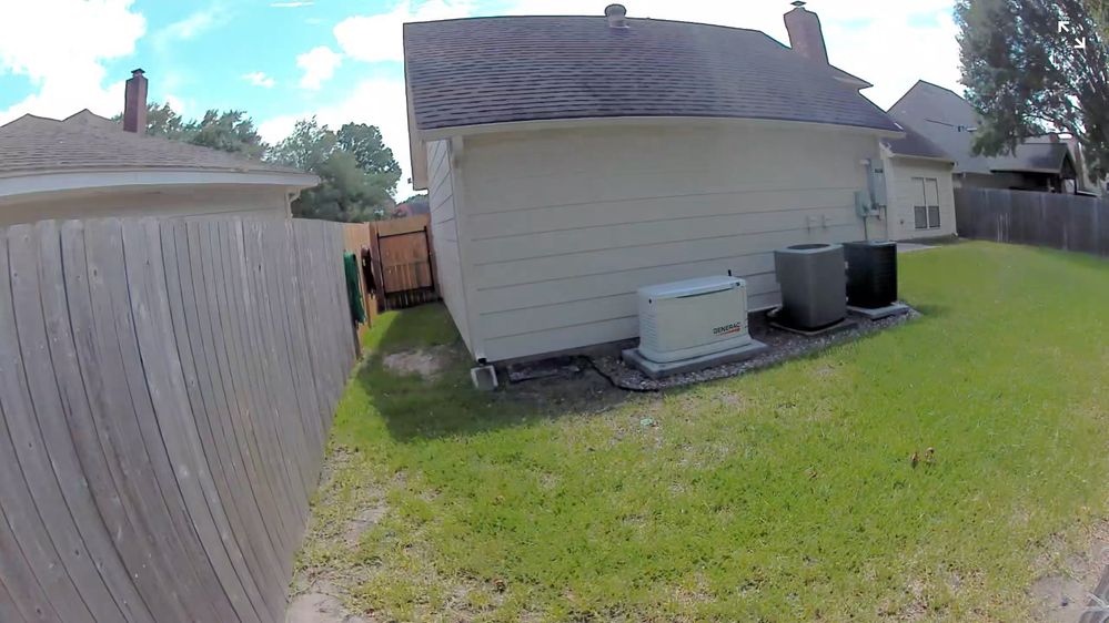

I have a pro 5 camera that is a little over a year old and it is pointed in the direction of the back of our house. It’s still pointing in the same position (hasn’t moved) but the lens is now picking up the sky and up to the left. It appears the internal lens has malfunctioned. Has anyone had this happen? Can it be fixed?
Likely you've already checked this, but just in case... Have you made sure the camera wasn't accidentally zoomed in? It will stay that way until you zoom out again.
I do not have auto zoom and tracking on. I toggled it on and then off just to see if that might be the issue and try to unstick it. Don’t think it did anything. We have taken the camera down at the moment (Beryl headed our way). This does look like it could be zoomed it……not sure how to fix it…
It appears that toggling on and then off the zoom and tracking feature has fixed the camera. It is now showing the view properly and is not zoomed in. So it is now working.
Thank for the suggestion to check the zoom function. Since I have never had that option ON for any of my cameras I didn’t think of that. Now how it zoomed in and got stuck there ….that is a mystery. It happened on July 1st when camera detected motion. Weird…..
