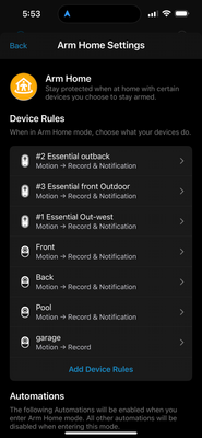

In general, you first want to configure the Arm Home, and Arm Away modes. Make sure Arm Away is set to arm all your cameras. Check that Arm Home only arms the outdoor cameras (has no rules for the cameras you want to disarm on schedule). The "modes" information here might help navigation:
After you've done that step, make sure "Arm Home" and "Arm Away" both do what you want.

What is it that isn't working? Your modes look right but we'd also need to see at least one of the rules. If they're all set the same, that one should be sufficient and doesn't matter as to which camera rule you're showing. In addition, we need to see how each schedule is set up. That should give us a good chance of figuring out what's up.

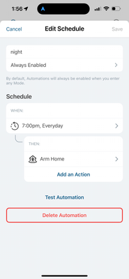

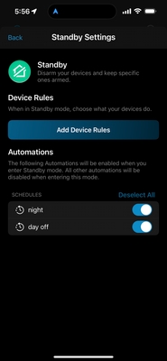

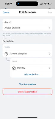

Can you post the screenshots for your two automations?
I would like the schedule to run every day. 7 AM standby, no cameras, and switch at 7 PM to “armed home,” all but indoor cameras.
both automations have all modes enabled

The screenshots look correct to me.
