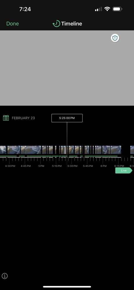

I have two of my Arlo Pro 4 XLs on 24 Hour CVR recording and have always had large blank sections of footage sometimes as long as an hour. Kind of defeats the purpose of paying monthly for the Secure Plus and two CVR plans. During the blank sections the cameras are unavailable and most of the time restarting the base in the ios app will fix the issue. More recently I have to restart it multiple times a day. Base Station: VMB4540r3 - 1.21.1.0_1399_9611cf3. Arlo Pro 4 - 1.080.20.1_23_d50a19d - Hardware H4. Internet Comcast Xfinity download speeds 1200 mbs unlimited data. Router is a Netgear AX5400 WiFi Router (RAX50) Nighthawk 6-Stream Dual-Band WiFi 6 Router, 5.4Gbps. iOS version up to date 17.3.1. Arlo App Version 4.12 (7365). During the camera outages all other Wi-Fi devices work fine and no tv buffering. I have tried all the troubleshooting tricks unplugging battery, resetting and re adding, wiping off the charging prongs, ect. Cameras have good connectivity. Seriously thinking about switching systems since I'm paying monthly for a subpar experience.

Do you notice your two pro 4 cameras going offline? These gaps are believed to be a symptom of the device going offline.
