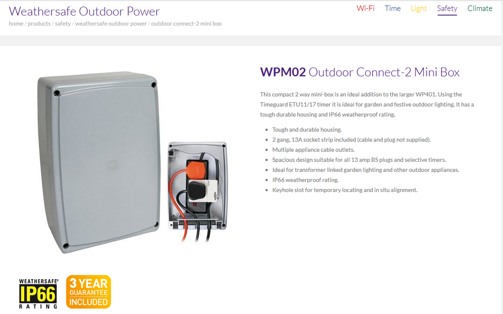

You can either drill a hole big enough for the USB connector on the cable to pass through, put the charger indoors, and seal up the hole with silicon or similar, or run AC power into a box designed for the job like this one (attached) and put the USB charger in the box. Modifying AC wiring outdoors requires a certified electrician in many countries by law. If that doesn't apply where you are, be sure to look up what a 'drip loop' is - be absolutely sure no water can get inside the box or into whatever space you're feeding AC power from.
