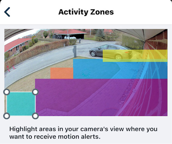

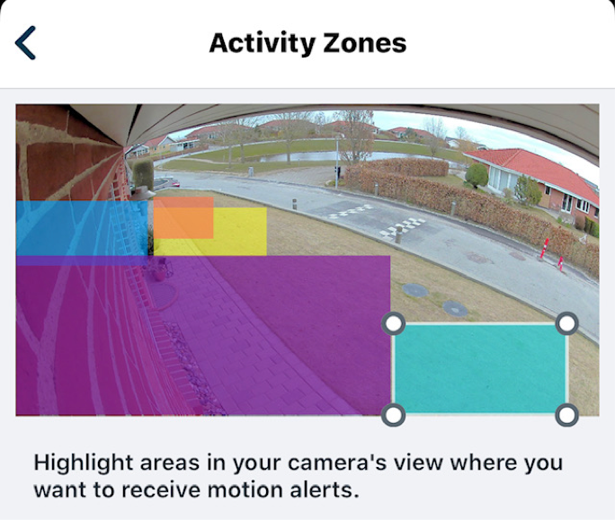

See attached examples:
Activity Zones Set
Motion Alert and SMART video available
Activity Zones Set
Activity Zones Set
