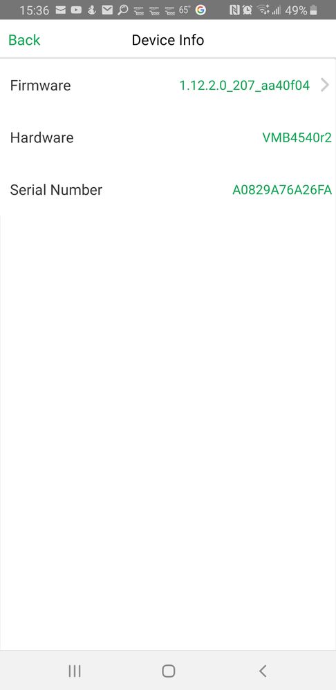

I'm still stuck at 1.12.2.0_207_aa40f04 (VMB4540r2)
That appears to be the most recent version for the Pro 3 base station. I believe the other posters are talking about the version on the Pro 2 base stations which is 1.15.0.....etc.

agree, but Pro 3 is what the thread refers to, this is why i had expected a solution for Pro 3 in the response from JamesC
@teutocat wrote:
@AncientGeek schrieb:
My interpretation of the original post is that the poster had a Pro 2 base and cameras to which he added a Pro 3 camera. So I think the thread refers to that configuration. We have to remember that Pro 3 designation refers to a camera as well as a base. So it can be confusing.
My Pro 3 base firmware version matches what others have posted here and I think it is the latest version for the Pro 3 base.
I think you are up to date.
since I started this thread a few asked my device info. here it is
