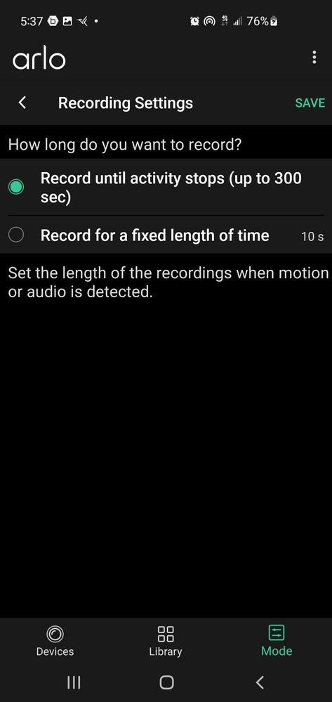

@Toledori wrote:
Here are my settings
You might try changing "recording until motion stops" to a fairly long fixed recording time, and see if that works better for you.
That sounds like you're using email notifications which won't be sent until the recording is uploaded. Push notifications should be close to immediate although Smart notifications can be somewhat delayed due to the need for processing to determine the subject.
How long is the delay? You can deactivate the camera(s) from Smart notifications to see if that speeds things up.
