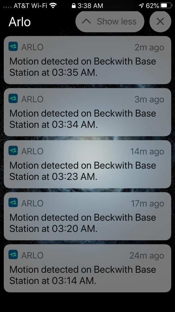

So given that I have the latest firmware installed on our base station, I just went out and walked in front of each of our 4 cameras.
The notifications I received on my iPhone X are all for Base Station motion detection.
None were for the individual cameras.
Refer to the attached screen capture.
When I view the library, the correct cameras are indicated with each of the recordings. Refer to the other screen capture.
So in response to your question, I would say the attempted fix is a failure.
