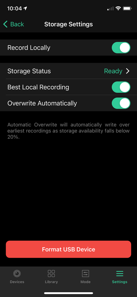

I am also having this issue.   Local recording access is no longer available and the app also removed the option to setup Direct Storage Access.  I had Local and Direct Storage Access setup and working fine, then one morning when i tried to checkout a motion notification, it would not let me select local to view the file.
I have tried:
 - Enabling/Disabling Record Locally.
 - Formatting USB
 - Ejecting/Re-Inserting USB
 - Deleting, Rebooting phone and then reinstalling App
 - Installed App on my iPad (brand new install, was never installed on that device).

Just an update..
My issue has been resolved with a SmartHub firmware rollback to v1.16.3.4_707.
Once support pushed that version to the hub, my recordings were viewable again and the Direct Attached Storage option was back in the device settings.
