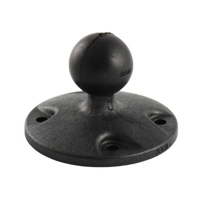

2) RAM Composite Round Plate with Ball - B Size
https://rammount.com/products/rap-b-202u
Note that you will likely need a socket with an extension in order to remove the nut in the plastic camera housing which secures the rubber ball's bolt to the camera housing.
The only snag I encountered is that the RAM B Size components use a 1" diameter ball, while the rubbery ball that secures to the floodlight plastic camera housing is slightly larger than 1" in diameter. The next size up that RAM offers are the C size components, which are for 1.5" balls, which is much larger than the Arlo camera's ball, so the B size is the closest match.
