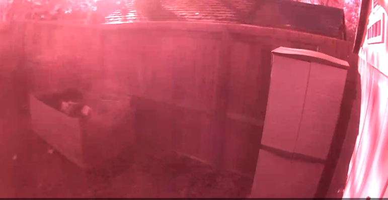

I've got a few Arlos already, 1 of which is not protected outside. The others are fine, but with the first **bleep** of Canadian winter, a little cold and snow has turned my video pink on that camera. Will the Arlo 2 Pro have better weather resistance to stop this from happening?
1 REPLY 1
Any Pro does not use the IR filters the original Arlos do so no problem. Pro cameras will turn off to protect themselves at -4F, though.
