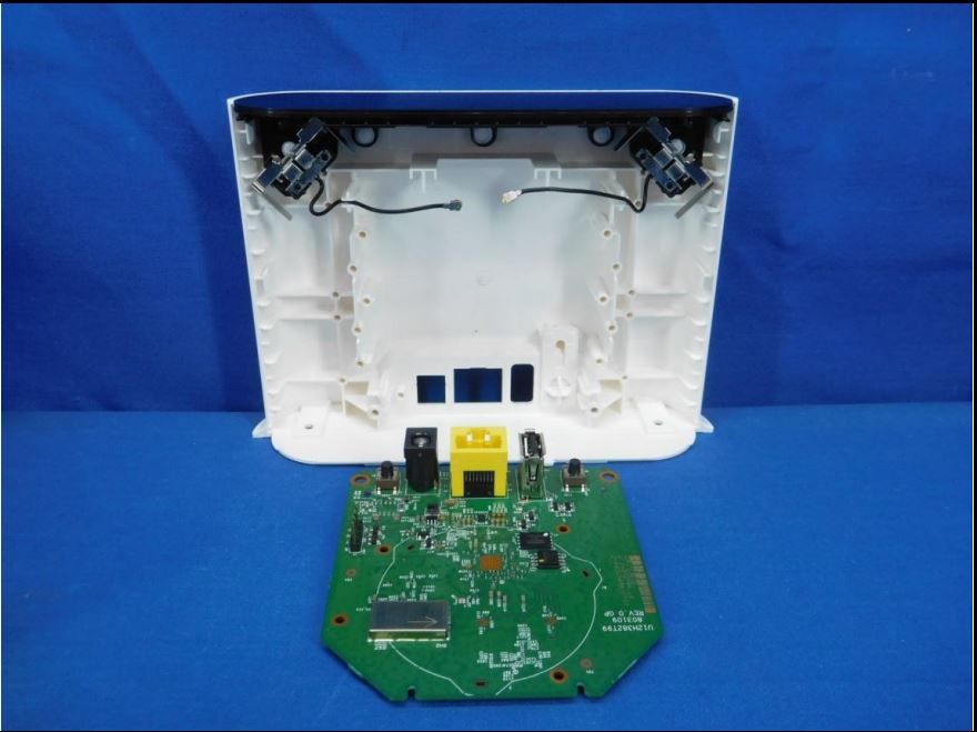

Here the photos of a disassembled VMB4000 are available: https://fccid.io/PY316200350/Internal-Photos/Internal-Photos-3113521
The internal board seems very different from the VMB4500 and also the siren seems a different model
It would be interesting to try and remove the shell in order to see if the siren gets significantly louder... Unfortunately it would break the warranty and I don't want to risk.
Buying an additional VMB4000 could be a solution, but I don't want to spend more money just because of a poor design of the new base.

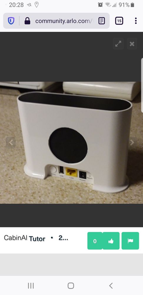

One problem with the 4500 is the lack of holes for the siren speaker. I used a 2 inch hole saw and a piece of window screen to correct that problem. Siren is now about 110db at a few inches and 100db about 12 feet away.
Hi CabinAl,
I opened up my unit too and it make an awful sound. I will modify the unit similar to your tip.
Is this a way for Arlo eliminate avoiding getting sued for hearing damage om consumer market?
Thanks for the tip this issue is closed for me now.!!!:
I think some Chinese designer just dropped the ball when laying out the case. Be careful handling the circuit board, there are static sensitive devices on that board and you could brick it pretty easily!
Hi no problem its not that sensitive on a populated PCB. Hole made window screen I skipped for now since it on the back of the unit.
Works fine now. Thanks
