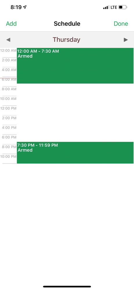

You have to set two schedules:
7:30pm to 11:59pm then the second schedule from 12:00am to 7:30am.

I seem to recall a problem I had once where I could not use the same mode on the other side of midnight. I created a new identical mode with a different name and used one on one side of midnight and the other on the other side of midnight. Perhaps this would be a workaround for you also.
