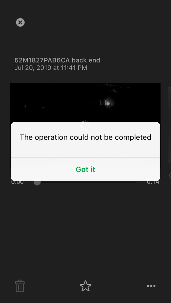

I keep getting this message operation cannot be completed at this time does anyone know what this means

On my IPhone 6 or 8, using the Arlo App, when click on the videos in my library, I get error message "The operation could not be completed. I have re-installed the Arlo App. Is this an Apple or Arlo issue? I called Arlo Support and they were no help.
How long are the videos? It may be that you need to increase the recording time to 20-30 seconds for them to work properly.
I could see my videos in library with on IPhone 6. Then in May 2019, the problem started.
Also receiving “the operation could not be completed” randomly, not every time, from both cameras. Just this morning we purposely triggered both cameras several times, a few videos worked fine, three did not. This is not the first issue we’ve had with this system and since we are out of the 90 day warranty you have to pay to talk to someone by phone?? That right there tells me they have no confidence in their products. This system is awful and believe me we tell everyone we know that is considering a security system to steer clear of Arlo!!

I don’t think record time has anything to do with my problem. I have a recording today that was over a minute long that worked fine. Shortly after that I have a 13 second recording that did not. “Operation cannot be completed at this time”. It did however have a still shot behind that box of the deer that triggered the camera. It just wouldn’t show a video. We triggered over 20 recordings today going in and out of the house and barn, some worked, some didn’t and a few didn’t even trigger the camera at all. No confidence at all in a security system that doesn’t work properly, I’m sorry I convinced my husband to purchase this junk.

@ArloAlex from the Product line management team has advised that a server-side update was released earlier this week that resolves this issue. Please note that this update will not resolve the issue for clips that were affected before the update was released, but future clips should not be affected. If you encounter this issue again on clips dated after 07/22/2019, please let us know so that we can follow up for more information.
