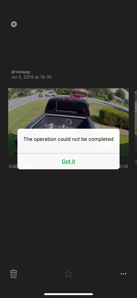

I keep getting this message operation cannot be completed at this time does anyone know what this means

I may have found a partial solution to the video clips not playing due to the error "Operation cannot be completed at this time"
While monitoring the failed video clips over the last few days I noticed that those that failed were invariably around 11 seconds long, (maybe 12), but longer clips consistently played.
Using that knowledge I went into the app, navigated to the mode option, then clicked on the pencil edit icon for each of my cameras, then the pencil icon for the "Record video" option, selected the Record for a fixed length of time and set a record time of 25 seconds. You can set it to a maximum of 300 seconds.
SInce I made that change all of my captured video clips are playing. I hope that it will work for most of you.
Now obviously this approach is not ideal and I am going to share what I found with the technical folks at Arlo but in the short term perhaps it will save a lot of frustration and possibly much more.
