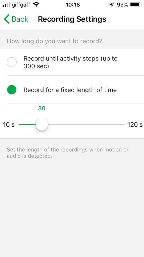

I followed the directions from some of the other users to change the settings to 30 seconds and have not received any errors over the past week. I have received over 50 alerts in that time and have successfully downloaded each video from the library without any errors. It appears that if you select the option to record until activity stops that users are still getting the error. For whatever reason, the 30 seconds setting has been working without issue. Hopefully Arlo provides a permanent solution since this is still just a workaround. Look at message 270 on this thread and they provide instructions to navigate the settings. I hope that it works for you as well.

It seems that altering the recording time to 30 seconds has given you some success but I have tried this numerous times and it doesn’t stop the error. I cannot get consistent recording lengths on any of my 3 cameras, two of which are on mains supply (using the Arlo manufactured cable). The length of recording is random no matter what time I set or if I choose ‘recording until movement stops’. I have attached screen shot of my setting for one of the cameras; confirming I’m in the correct mode setting.
