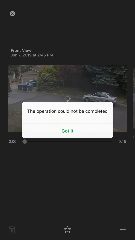

I keep getting this message operation cannot be completed at this time does anyone know what this means

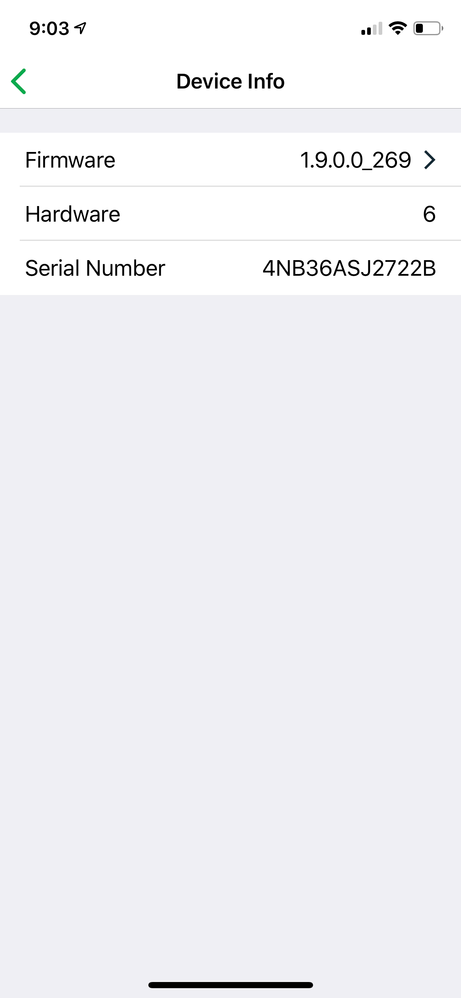

Attached is screenshot of device info. Other than serial number, it’s the same as the other Arlo Q that is working fine.
On IOS app, I get the Operation Cannot Be Completed modal dialog with Got It button. If I try to download using same app, I get the cocoa -1 error. It also will not work on safari. Will not work on Win 10 / chrome. All environments and apps are current.

The reason the error appears is because the audio header in the mp4 file uploaded to the cloud is incomplete and iOS App spits the dummy as apple does not allow a null audio format. This is also why you get a cocoa-1 error when you try downloading the recordings. This is documented on the apple developer site.
The android devices ignore the faulty header so they play the files with out the audio.
If you use the web portal say on chrome, the recordings do not play using Flash but you can download them and play the video using VLC that initially throws an audio error.
Where the error is occurring is undefined but likely in the cloud recording system itself.
If you check the USB recordings they are not impacted using the latest firmware.
