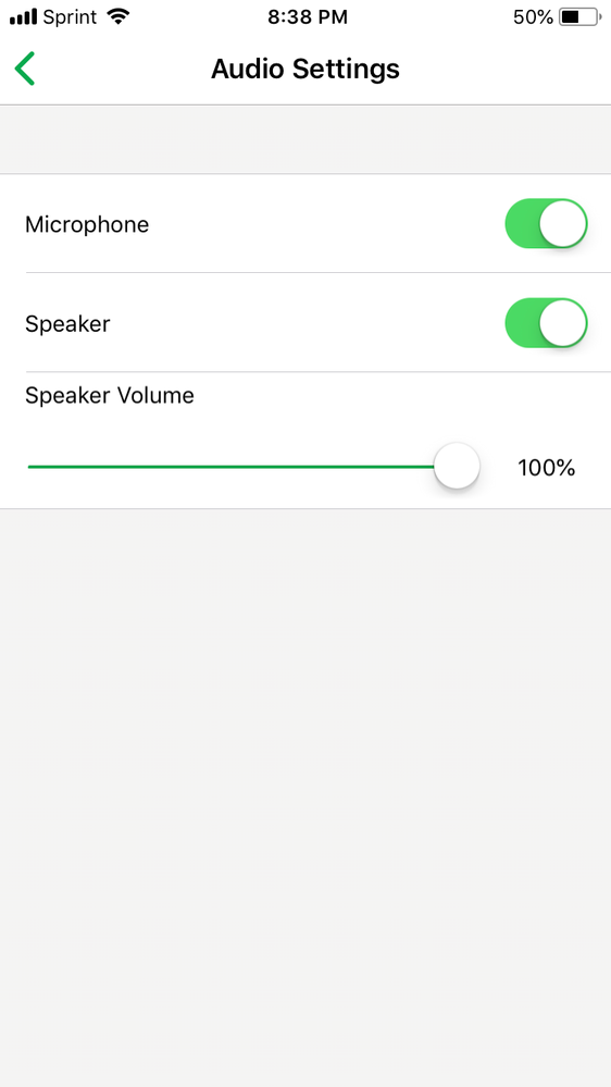

If I click “Press to Talk” the othe person near the camera can’t hear me. I have made sure that the App have access to iPhone microphone.

I can use the microphone to use the two way talk through my computer but it will not work on my phone. I can see the microphone button pop up on both devices but when I hold it down on my phone and speak through it, I get no sound through the speaker on the camera. Do they only work when you are away? Is there any way to test them? I cannot hear anything when I am in the room trying to get them to work.
