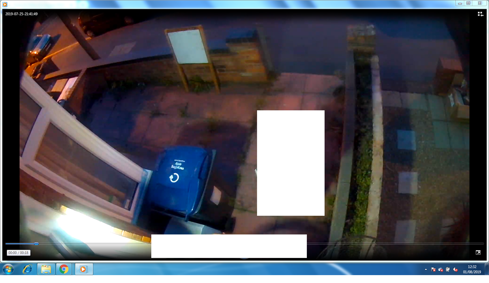

At night time, my Arlo camera were recording "Black & White video clips" as my family member was talking underneath the camera. After recording one clip in B&W, it recorded "Colured Video Clip" about 10 seconds and changed back to B&W for rest of the same clip.
I am sure, Arlo Pro-2 hasn't got ability to record "Colour Video" at night time. How this happened?

Do you happen to have a screenshot from the night vision video you can provide?
Please find two screen shots (couple of seconds difference at night time).
It appears the camera is detecting enough light to not initiate the IR for Night Vision. The screenshot sent appears to have enough light to record in color. The camera can't record in color at night unless there is an extreme amount of light shining on an object/background. At this point, if there happens to be this much light, the night vision will not turn on anyway.
