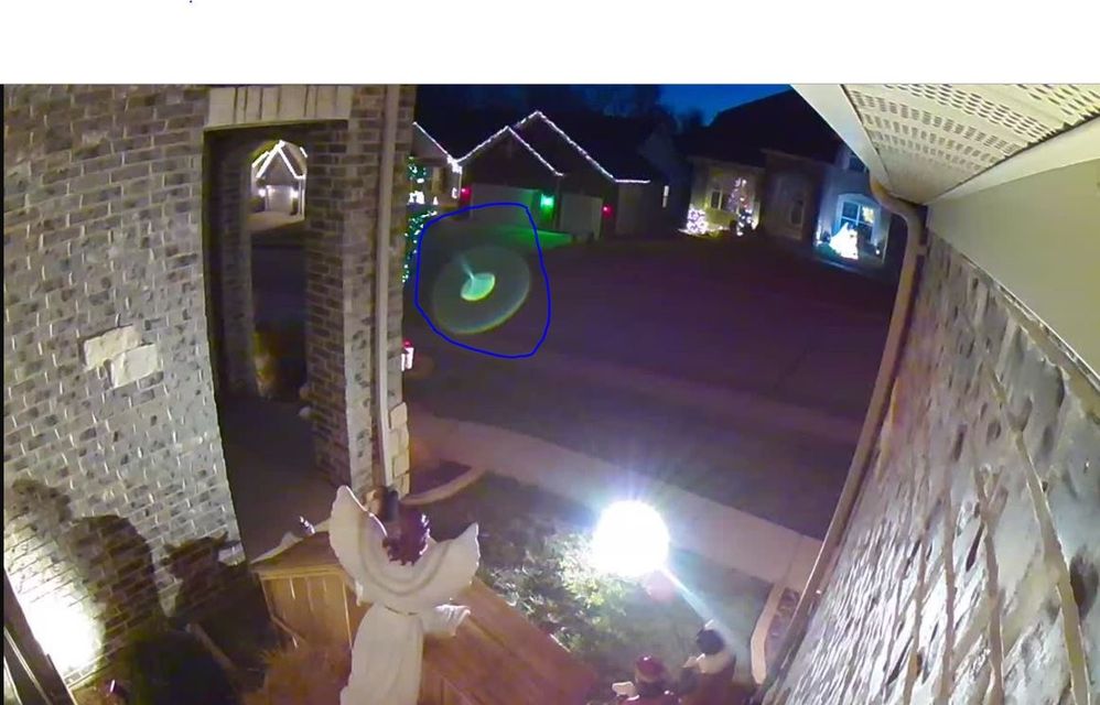

Good Evening, I just set up a new Arlo Pro2, and when I view the footage on the camera there is an add object in the frame....I am not sure what it is, could be a reflection off something? Any ideas on how to correct this. The other camera that I setup does not have this issue

Looks like glare from the light. If you move the camera angle slightly, does it change position or disappear?
That is an internal reflection from the bright light. It is reflecting off of the sensor glass, so it is symmetrically opposite from the light source. This kind of "glare" is common in wide angle lenses of the kind that Arlo uses.
