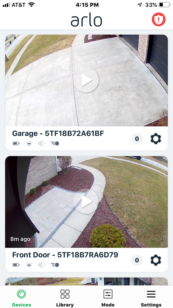

Dannybear
Master
Master
If your referring to the basic activity zones, look under the camera’s device settings.

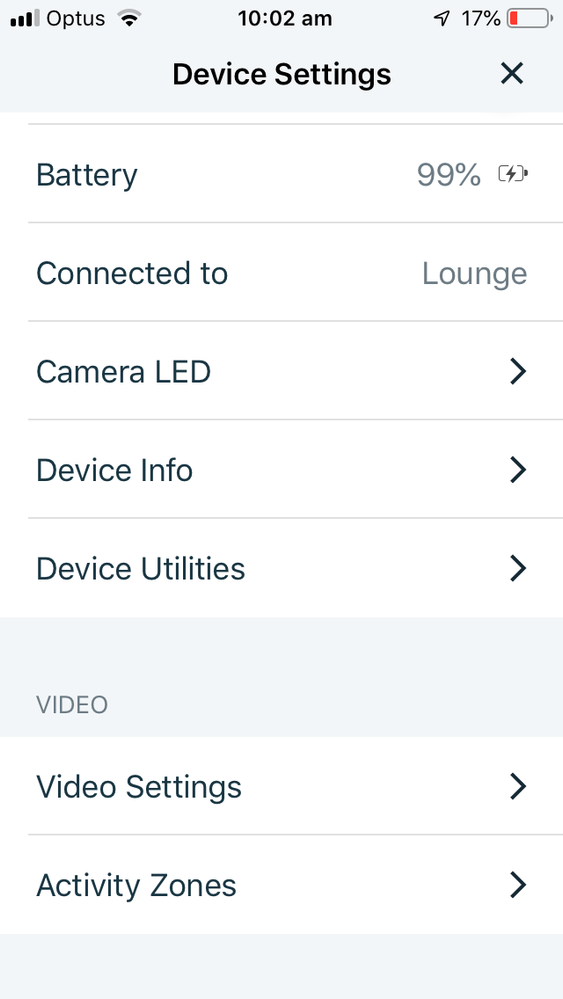

Dannybear
Master
Master
Just confirm you have a pro 2 camera.
The activity zone should be in the video section.
Refer attached for iOS App.
Dannybear
Master
Master
Ok, I see what your talking about when you go the long way to get to the camera settings.
From the devices page, I just tap on the settings icon for the wanted camera and it takes me to the camera settings.
If I tap on the settings at the bottom right of the App then I tap on “my devices” I then have to tap on the wanted camera to get to it’s settings page.

JeffNolan18
To confirm I have just an Arlo Pro.
In my app I don’t have Activity Zones below Voice Settings like you are showing me in your link. All I have showing is Video Settings and below that Audio Settings.
