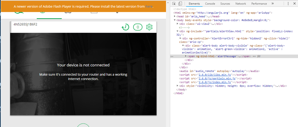

Nice 4U. We haven't - not with Version 70.0.3538.102 (Official Build) (64-bit) on Win 10 64bit (up2date) here. Tweaking the browser should not be required - just had to reset things troubleshooting some NTGR Insight issues, and found cut off Arlo again. Further on, Flash is on the way out of the door - it will be gone before the EU warranty for new Arlo cameras will expire. Come on Arlo people - it's time to say good bye Adobe Flash now! The horse is already dead. Stop riding it.
While talking: It's the Arlo portal pushing this Flash update message. Appears the product engineering does not want to understand that you can't update Adobe Flash if running Chrome (for years!). Proof how far from reality they are now.

@jguerdat wrote:
It's not Arlo pushing the Flash notifications - it's Chrome reacting to the request to use Flash.
Don't agree. This is an Arlo portal page controlled notification. As such it must know that it's running on Chrome and able to discover that it' can't launch Flash - which does (again for the records) not allow any other but the built-in Flash. As such, the message is wrong in any aspect!
