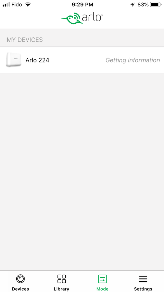

I just purchased arlo pro 2. When trying to get into mode using iOS, I do not have options, it just says “getting information”.... My friend has a arlo pro and is able to go to modes, and has pencil for editing...I don’t have that option at all.
1) the 4th camera supposedly syncs but does not show up on the app or on windows.
2) the app, under mode, states "getting information" and will not allow me to access the base. I can access the base via desktop computer, but it will not allow me to change my settings/commands.
3) while on the desktop, although i can see 3 cameras (can not get 4thto connect), when i attempt to edit the modes, it does not allowme.
PLEASE HELP!!! This is frustrating. I want to be able to know when the cameras have been activated without having to watch it live all the time

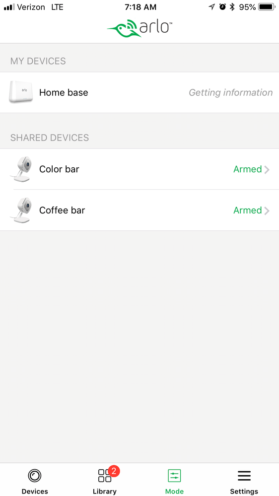

Just an observation! I have read the threads and I guess it's on US, we did't do enough homework on your system. we spent nearly 450$ for your system and not much return for the money! Can NOT get the "Mode" to come on, keeps saying "getting information" I see that is a common theme since May 2018 update. (I have a friend who bought a 200$ Chinese piece of junk that works better than this, ALL 4 of his camers work and are motion detected, his system works like this one is supposed to) So! Online help Chat "dosen't work" called the support number, (at least I did speak with someone who gave me the instructions on what to do, Delete app, reset system with a pin on the back, reinstall the app, reset set the cameras, worked for about 8 hours. NETGEAR------You are better than this, I have had MANY of your producets over the years, VERY DISSAPOINTED.

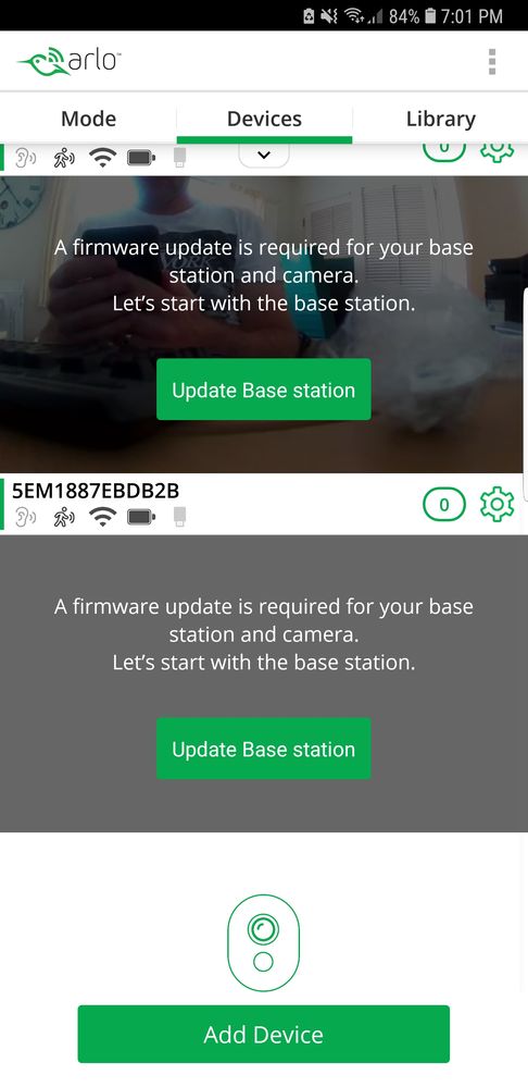

@Redmoonstar Thanks for your response mate, I just tried all that you suggested but unfortunately it didnt resolve the issue. I did take it back to the store yesterday and they gave me a brand new unit to try, this time i documented each step and took screenshots etc. I was hoping that I could get by with a new unit without the firmware applied until an actual fix is released but unfortunately it forces you to upgrade if you want to use the live view. At least I was able to document that it does indeed work until the fireware update is applied which kinda rules the phone out as the issue. This time I set the mode to Armed before I ran the update so at least if the issue happened which it did the system would work. So just for those who are wondering exactly what happens after the update:
1. You loose the mode option from the app so you cannot disarm, Arm, schedule, geofence.
2. The web portal locks down the mode option also, I tested that before the FW update and I was able to select different modes, but not after.
3. The FW update will lock the system into what mode you have selected at the time.
Here are screen shots to prove there is in fact a major BUG. !!!!
App before the Update
App after the Update
FW update that breaks everything
So come on Arlo release a fix for this.
Just an update for everyone that has this issue. I spoke with the Arlo support team over the phone and have an offical response. They confirmed that there has been issues with modes since a recent update so the current FW release removes the mode option completely until the engineers have resolved the issue. Also we can expect a new FW over the next couple of days that will resolve this issue.

For two days my Arlo has been stuck on "getting Information." The geofencing is working reomtely but I am unable to see my devices. I have rebooted the base station twice now - once in person , and once remotely through my app. I looged onto the arlo through my work computer but other than allowing me to change the mode, whcih I am unable to do in my iPhone app, I cannot see my cameras and it still says "Getting information." I need this sytem online so I can see the cameras.
HELP!
The Arlo Pro 2 Base Station purchased today clearly have software bugs. The base station was upgraded with the new firmware when setting it up. The base station has issues getting all the funtionality to work, on the iphone app, My Devices it says Getting Information and the Arm/Disarm functionality does not appear. The base station syncs with the cameras just fine.
When logging in via browser the base station is in an Armed state and not other options can be choosen.
Your only option is to turn off the camera to avoid the camera sensor going off at all time.
I have tried reboot, pulling the plug, reset and adding as new.
I have a second base station in my system installed 10 months ago that works well. I have not upgraded the firmware on that one.
The system is unusable like this and requires immediate attention from the Arlo people.
