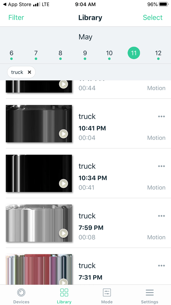

Camera is starting to show vertical lines. See attached image.
My camera just stared doing this all of a sudden. Any reason why? There was a car accident in front of my house and it didn’t even capture it, the driver drove away.

There's two issues here - video corruption and also lack of recording.
The corruption may or may not be due to signal strength or quality. Possibly rebooting the base and reinserting the camera batteries may help.

I haven’t thought about rebooting, I’ll try that today. This camera is up on the garage, we live in a tiny gated community it does a great job other then it occasionally not powering up thru the solar panels.

Same here. 2 cameras started to only show verticsl lines. Did a base station restart. One camera finally came back but one still just verticsl lines.
Base on this thread, will try a camera battery pull restart to see if thatveorks.
Ri did the battery pull restart. Camera vertical lines went away. It showed on short live image then froze. Now showing off line. NOT VALID ERROR as this camera is nearer to base with clearer line of site that another camera. Plus prior to this issue, this was always quicker to load than other cameras. Beginning to think Arlo cameras a mistake. I've been fighting a Arlo Go offline condition for 2 weeks which Verizon blamed on the camera and now an ARLO Pro2 camera issue. And I'm seeing zip company support.
Arlo reached out to me and sent me a new camera. They sent me a new camera which worked great for 3 days, now it’s back to the lines, recording for 2 seconds or just a black screen. I’ve taken out the battery, did the restart I’m now ready to chuck the damn camera. Is it possible maybe it’s the basestation?
