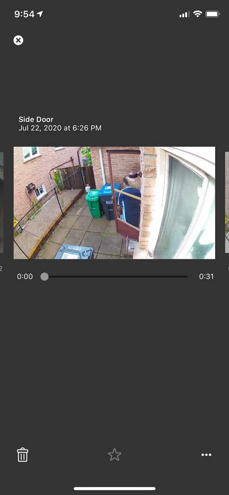

Looking at the included screen shot ( ignore the person, I picked it for the intense reflection as an example only) could this be the cause of my many unwanted videos?
It could be the reflection off the window looking at the photo. Not sure if that is what you saw.
It coukld in fact be the reflection from the window. If something causes the IR to vary sufficiently (clouds, airplanes, etc.) it will be detected as "movement".
