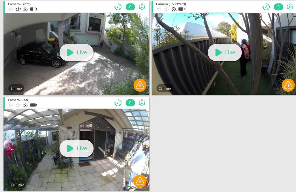

1) erroneous Badge Count in iOS app.
2) Same (probably correct) Event count in macOS app
3) macOS Event Count cleared fr each Camera (tap on the Event Count in the top bar of each Camera)
4) Cleared Badge Count is now reflected in iOS app

Shayne,
Here are the four screen captures...
I do not understand why they did not imbed in the original post, all I see is this symbol.
I give up...
