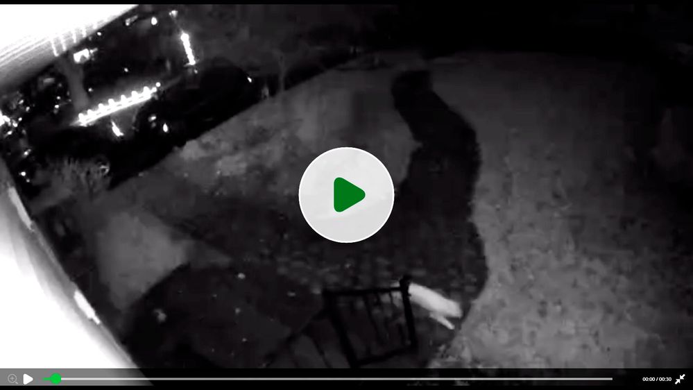

Here's a Pro 2 screencap. There's minimal light apart from some fairy lights my missus hung. I'm pretty happy with the night vision
