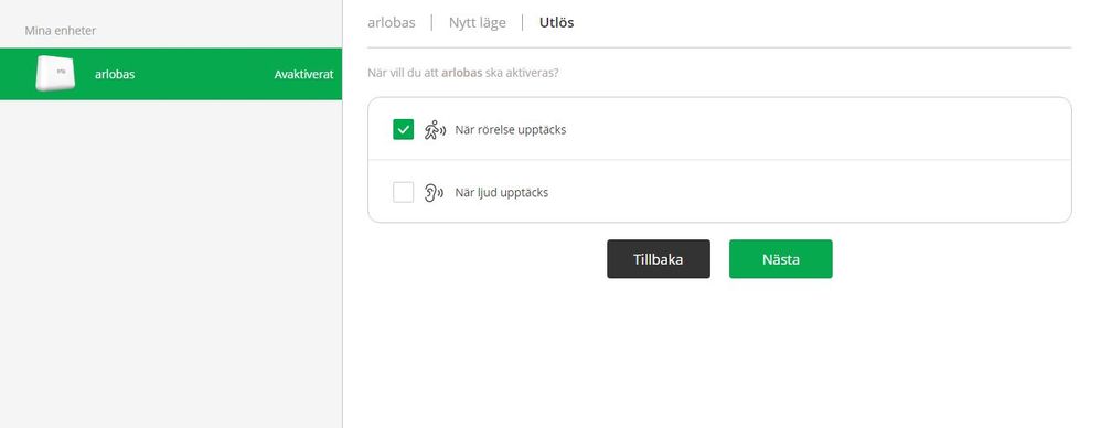

I have no such option. I can NOT clear the check box for the trigger I do not want to use!!! There's no such option at all! What I've got is shown in the att. file Screen2 (in Swedish)
You must choose motion and/or audio detection in order to go to the next step.

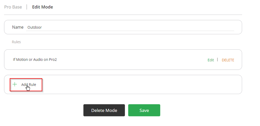

Once you created your first rule with the first camera, you can hit "Save" .
Then click on the arrow/pencil icon next to the mode you edited and tap on "Add Rule" to add another camera and follow these steps until you added all the cameras you wanted.

If you are using the app for this, you might consider doing it in the web ui (my.arlo.com)
I suspect you have the concept by now, but just in case...
Each mode is a set of indedendent rules
Each rule starts with a motion detection trigger for a specific camera. After you set up the trigger, you set up an action that happens (perhaps on another device) when the trigger is activated. In English that is in the "then do the following" section, You can add additional actions for other devices.
So if you want to activate three cameras that work independently, you create three different rules, each one identifying the actions (recording, notifications, or activating the siren) for that specific camera.
If you want to activate three cameras when one detects motion, you create one rule, with three different actions.
In summary, the mode structure is
Rule1:
If (Motion on Camera X)
Then do the following
Camera X (record video)
Camera Y (record video) [if desired]
Turn Alarm ON (checkbox)
How would you like be notified?
Push Notification (checkbox)
Send Email Alert (checkbox)
Rule 2: (second structure)
You do need to keep track of where you are in the process (knowing whether you are adding a new device to the "then do the following" bit or a new rule). And you do need to be careful to save the rule - sometimes you need to scroll up or down in the web client to find the save control.
