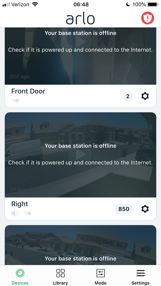

I would like to add to the discussion that it's not only the VMB4000 which is affected by the problems described in this thread. I am wondering why the thread is marked as solved, because apparently it is not...? My older base station VMB3010r2 is showing the same behaviour for some weeks now (nothing changed in my network environment):
The systems goes offline and only comes back, when power-cycling the base station, with cameras reconnecting automatically. But while the base station is down, the cameras are suffering from a dramatic drop in battery power. I have replaced the batteries in two cameras, one on Sunday, one on Monday. After the base station being down yesterday, the batteries dropped to 66% / 76%.

Went offline this morning for first time, and no support from chat and phone line super busy, NO ARLO SUPPORT help!
See any public message warning people not to use the flash drives. It’s very irresponsible not to warn people - not to reimburse them or fix the problem. And not offer any information on eta of fix either.
It’s not just USB’s that are the issue, my two base stations don't have usb functionality as other posters on here have said, and they are effected,
Just the worst. Finally heard back and they are agreeing to replace the base station. The wrinkle is they want me to ship back the base station at my cost, then I get a new one. That is total crap. Still under the year and I paid for a premium storage account. I had to email them twice just to get this far. The other option I have is to pay $20 bucks and they will ship me the new one first. Their customer service is just horrible. Just terrible.

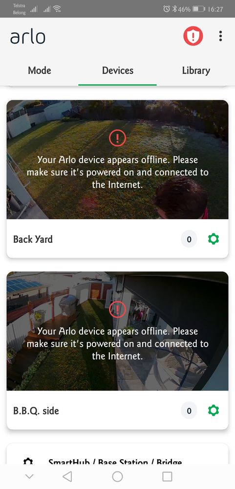

I've been dealing with the "offline" issue for months, usually having to do a reboot or cold start on the base station. The community as a whole has been dealing with this for months as well, and Arlo/Netgear does not seem interested in addressing the issue, or is unable to provide a solution. Unfortunately, when I'm away as I am now, I am unable to do the "fix" and my camera system is worthless. I'm done. It's time to move on ...
Ditto for both original Arlo and 2 Pro systems. Argh.
We have one of the basic Arlo wirefree systems with 3 cameras and the bas station will just randomly go offline. We have an model VMB2010r2 base. I have added a Wemo on it to restart remotely and it's a pain because if I don't notice for more than a couple hours, I have to reset cameras as well. It's running cuttent firmware 1.12.2.4_2772
Anyone else having issues?
I used the Arlo Pro system with 2 cameras during months and it worked perfectly.
Since a few weeks I'm having trouble as the base station appears to be offline while all leds are green and my internet connection is working fine.
When I remove the device from my smartphone, reset the base station and reinstall everything on my phone everything works fine but it lasts only for a couple of days.
I did this about 10 times ... I'm really geting hopeless and wondering whether it isn't a hardware problem.
